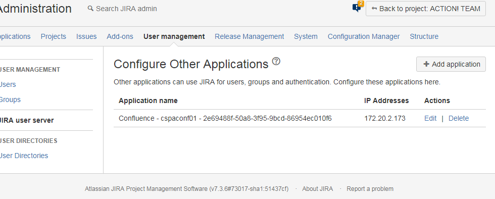

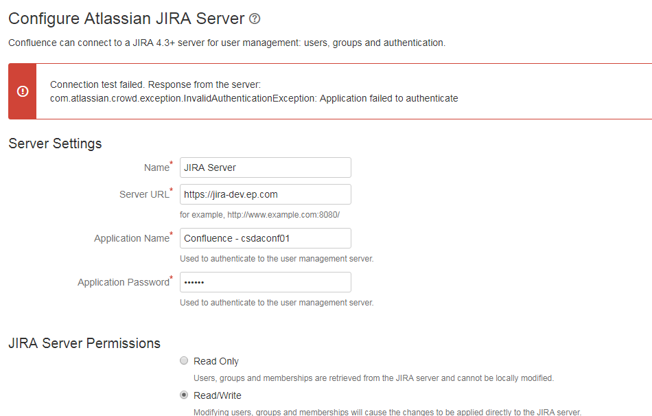

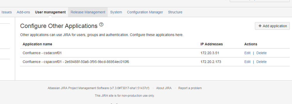

i configured whitelists also but i can't able to connect to the cofluence SAVE_20180404_020912.pngSAVE_20180404_021012.pngSAVE_20180404_021018.png

The two Confluence applications defined in the Jira User Server have different IP addresses. Please make sure to use the IP address that Jira will see the requests coming from. If there is a proxy between the two applications, make sure the proxy IP is also allowed by the application and is on the Jira whitelist.
For testing, please set up a simple application in Jira User Server called simply "Confluence" and with a very simple password, and make sure to use the right IP. Once we have proven it works we can refine the setup.

Your confluence cannot log into that Jira given that application name and password.  Have you set them up identically on the Jira server?

There's not a lot more I can tell you.  The error you are getting means that the application name and password you are passing over are wrong, or that there's something blocking validation.
Have a look at the logs on both sides at the next time you try the connection.

You need to tell Jira that it is going to be used as a directory by Confluence, and set up the access name and password for that, then use the same details in Confluence.
