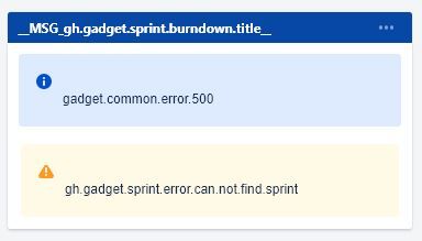

In the Dashboard, I get the following error: __MSG_gh.gadget.sprint.burndown.title__ of the different gadgets. Other related errors, gh.gadget.sprint.error.can.not.find.sprint

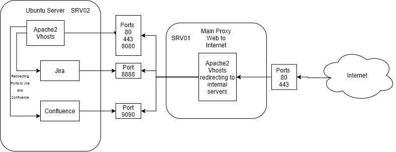

The following scheme is part of my server with JIRA and Confluence, and another proxy web server, with redirection from outside to private servers.
