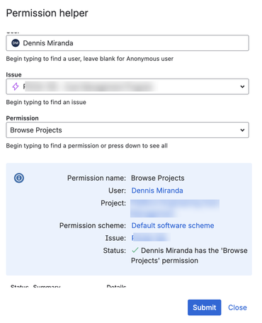

Your admin could use the Admin Permissions Helper to generate a screen image confirming that you have that permission. This would be an example of confirmation:
dmiranda
January 23, 2026
It does say that I have the "Browse Projects" permission
