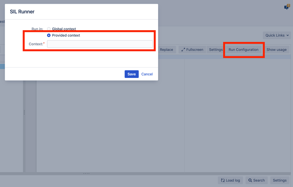

I believe that the project variable is null in your script. How do you run your script? If you run your script from the SIL manager then you should set the context for the script. You can do it by pushing the Run Configuration button and set an issue key in the Context field:

Thanks a lot
