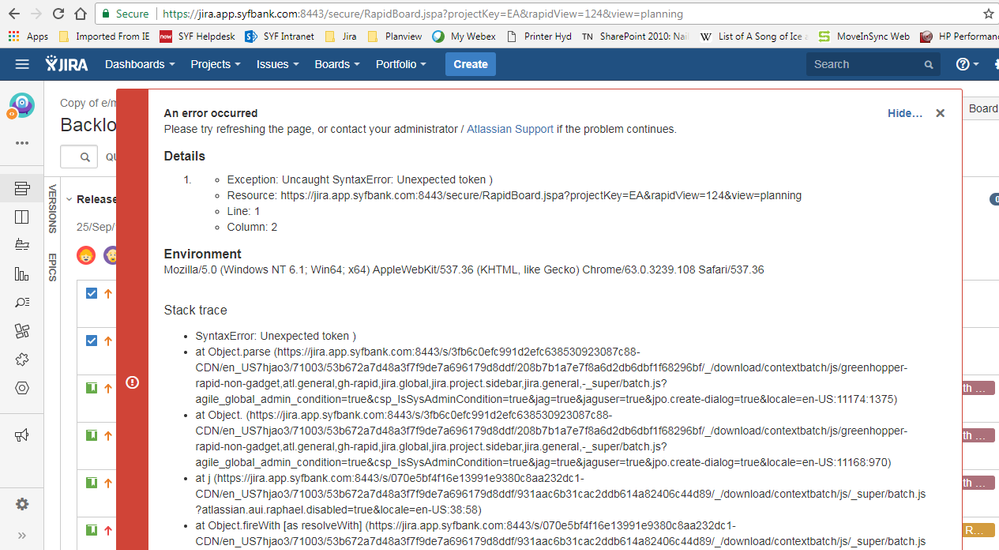

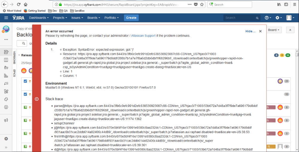

Raghavendra Amara
February 7, 2018
Shannon,
We have only two extensions in Chrome, one is "Cisco Webex" and the other one is "Symantec Extension". Both these are not enabled for incognito. But still I get the same error when opened in incognito mode.
I am attaching the error screens from both Chrome and Firefox. Hope this helps.

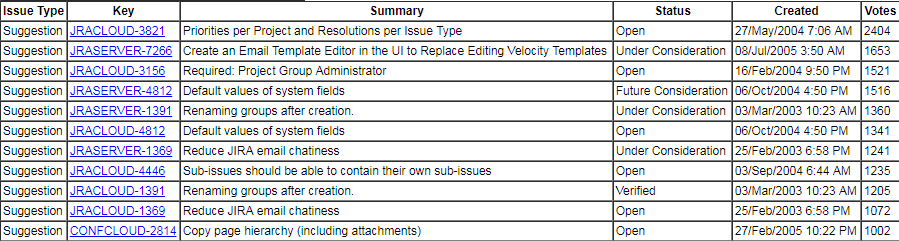

boardtc
February 20, 2018
Thanks for letting me know. I'm not holding my breath considering Atlassian has open tickets 13 years old with thousands of votes:
Query: jira votes.png
I emailed Grammarly to let them know earlier.
