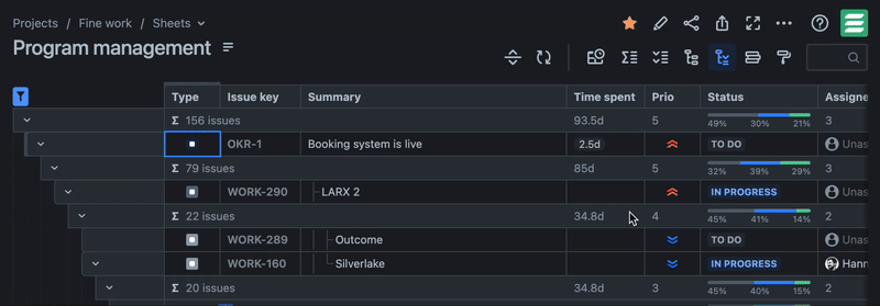

Following up on my earlier answer   if you do want to keep subtasks and have their hours roll up to the parent Task without maintaining an automation rule, that part is also doable with an app.
If you are open to solutions from the Atlassian Marketplace, the app my team and I work on, JXL for Jira, handles this with sum-ups. JXL is a spreadsheet-style view of your issues, and sum-ups aggregate any numeric or time field (Original Estimate, Remaining Estimate, Time Logged) from subtasks up to their parent Task across the hierarchy. The rolled-up hours show on the parent row with no fields to overwrite and no rule to keep in sync.
Because the view is a Sheet, you can also enter and adjust all your hour estimates inline in one place, then read the totals per Task. It is purely a view and reporting layer, so it does not change how Jira stores estimates or how your board behaves.

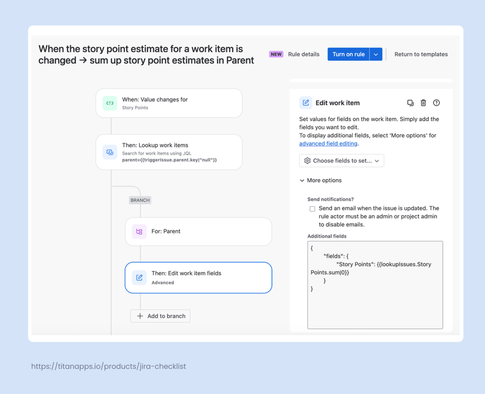

There's actually a native way to handle this if you want to keep using subtasks. Jira Automation has a rule that rolls up child estimates to the parent: when a child's estimate changes, the rule recalculates the sum and writes it to the parent's estimate field. It's most commonly shown for story points, but the same mechanism works for hours too. So your parent Tasks would end up with an accurate hours total based on what's been estimated on the subtasks.

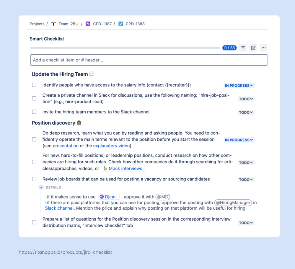

If you are open to trying out a dedicated marketplace option, I can recommend our solution Smart Checklist for Jira. It allows you to add feature-rich checklists to Jira work items and save them as templates. Each checklist item has its own status (To Do, In Progress, Done, or any custom status you set up), and you can also add an assignee and deadline, links to external documentation, and more. Each checklist item can also have an expandable section with details where you can drop anything you need, from bulleted lists to images.
With this level of detail on each item, you basically get the same functionality you'd otherwise get from subtasks. Here's what it looks like:
Checklist progress can also be shown on your Jira board, if needed. Each Task card displays a completion percentage based on the checklist. So you get the visibility you'd normally get from subtasks, but without cluttering your board and without the subtask-level estimation mess.
For the service side of the team, the template feature is especially handy. You can save checklists for recurring tasks and common request types as reusable templates and apply them to new Tasks automatically.
