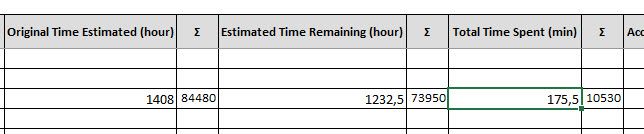

In JIRA, we have a parent issue with 26 sub-tasks. We've estimated our sub-tasks and on the parent we see a total estimation of 1338h but if we sum the sub-tasks manually we arrive at 1408h. Also, if we run a time-tracking report, it also shows 1408h as total estimation.
On the parent issue, it also says 1180h30m as remaining and 177h as booked time. The sum of those is 1357h30m. So it's not even close to the shown total estimation or the real total estimation.

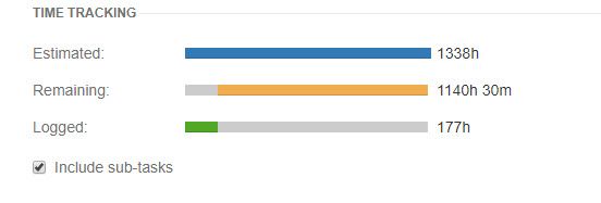

We are looking on the normal task. There is no estimation/remaining/logged time. All numbers are 0.
If I check the box the estimated becomes 1338h, 1161h30m for the remaining and 177h for the logged. (I've updated the remaining time on some sub-tasks so now they are in line)
The total is still wrong unfortunately.
This is the screenshot from the parent task:
and this is from the report (exported to excel and divided by 60 to get hours). As you can see none of the 3 numbers match:
