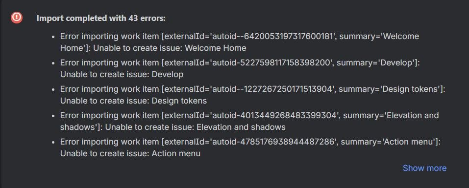

I'm trying to import 43 new stories into an existing Space using a CSV file. I have set the CSV delimiter to ';' and mapped the three fields, but keep getting the same errors, as shown below:

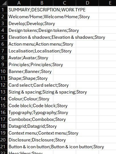

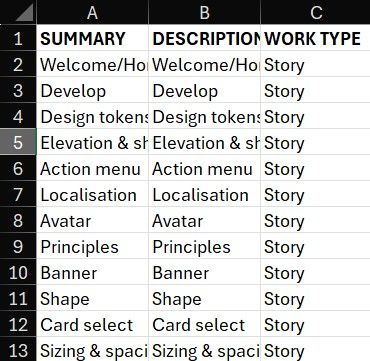

This is a sample of the data I'm trying to import:
Any advice please šŸ™

Hey @John Funk , sorry, I'm not sure what you mean by this :( When creating the Excel file, each value is in a separate column:
John Funk
December 9, 2025
Thanks for that. So, you are then saving as a CSV file and doing the import - correct? And you choose the comma as the separator, correct? And you still get the error, correct?
I suspect the import is not liking the / and maybe the & either. Try replacing those with something else like and or maybe a dash. Then save and try the import again.
Or just save it separately and delete out everything but one or two rows without those special characters and see if those work.

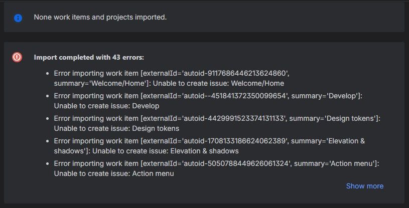

Alas, following all of the above, I still get the same errors :(

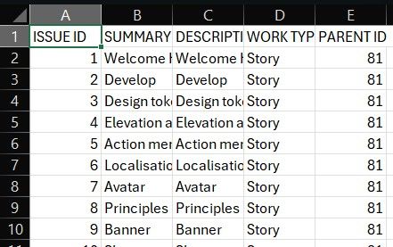

I discovered I needed to specify the parent when adding a work type manually. I therefore updated my CSV file as follows:
I also tried it with the Parent ID in full, e.g. PRO-81.
 The only mapping option for issue ID was External Issue ID and the only option for Parent ID was Parent. Neither worked, resulting in the error: You have to define which CSV column maps to Issue Id if you want to import parents.

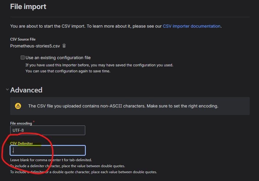

The CSV file needs to use a comma as the delimiter, not a semi-colon. Have you done something to tell Jira that you are using a semi-colon instead? I did not find a way to do that (yet).

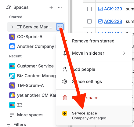

Into what type of space are you trying to import the data? Get that info by clicking on the ... next to the space name in the panel on the left. The type information is at the bottom of the pop-up.

Is this Advanced option not for specifying the delimeter:

It's a Company Managed Space and I don't change the field mapping.

Trudy P Claspill
December 8, 2025
You are correct @Maxine Freedman-Thompson .
I never look at the advanced options because I am either creating my CSV files with a text editor and using commas, or when using a tool like Excel I put each field in a separate column and then save the file with the CSV format option, as @John Funk suggested in his reply.
