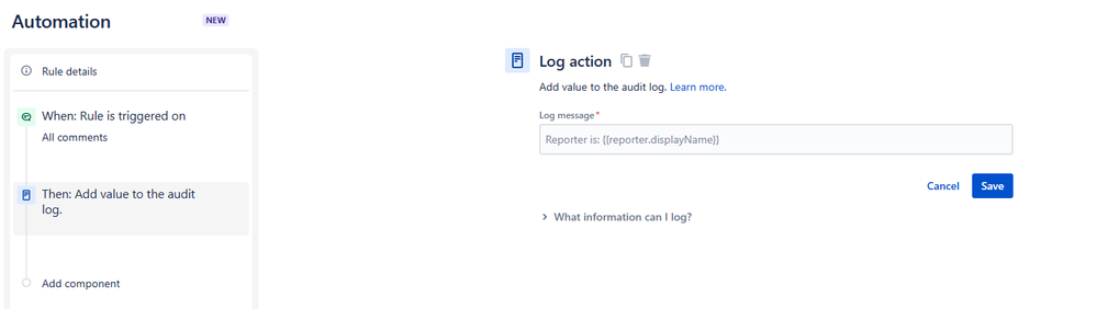

Valerie Knapp
May 30, 2023
Hi @Claas Babendererde , thanks for your question.
If you aren't getting a clear reason for why the automation isn't working, I typically also add an action putting the same calculation into the audit log -
You could also put different variations of the calculation in here, to see how far you get before it fails for example.
{{#=}}{{issue.customfield_10091}}{{/}}{{issue.customfield_10090}}{{*}}{{issue.customfield_10081}}{{*}}{{issue.customfield_10092/100}}
Like
and so on. Have you already tried something like this? What was the result?
Claas Babendererde
May 30, 2023
Thx so much for your suggestion.
I did not get the reporter thing working nor did I understand how it could help me. But I tried to ease the calculation.
You need at least {{#=}}{{issue.customfield_10091}}{{/}}{{issue.customfield_10090}}
It works!
