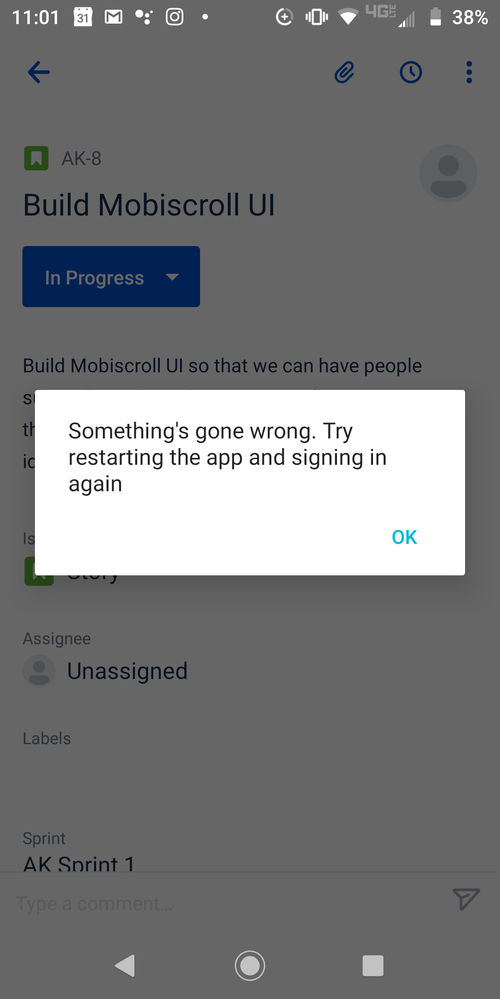

Hi, I am also having a similar problem, every time I try to click into a story or and Epic I get this error message. I am using Jira Cloud App on a Moto g6 Android phone connecting to a Jira Cloud account
