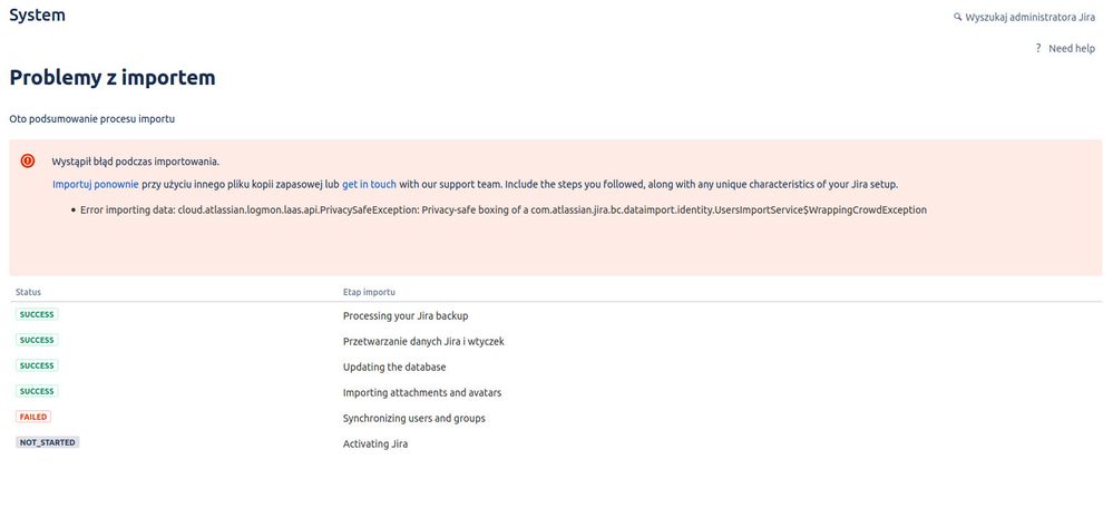

When I impot the data, I get this message: An error occurred while importing:
Error importing data: cloud.atlassian.logmon.laas.api.PrivacySafeException: Privacy-safe boxing of a com.atlassian.jira.bc.dataimport.identity.UsersImportService$WrappingCrowdException

The error message during import happens in state "synchronizing users and groups". This is clearly visible from screenshot but the reasons are not.
