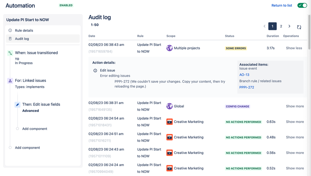

Good morning Bill, thank you for your help! Here is the JSON for the automation rule:
{"cloud":true,"rules":[{"id":13700897,"clientKey":"d88b9191-773c-3001-ac86-ac5e2a5ecd89","name":"Update PI Start to NOW","state":"ENABLED","description":"","authorAccountId":"712020:977bff7a-a0c5-4ee1-ac25-7c01a7a56f5b","actor":{"type":"ACCOUNT_ID","value":"557058:f58131cb-b67d-43c7-b30d-6b58d40bd077"},"created":1690551082369,"updated":1690976583837,"trigger":{"id":"298102707","component":"TRIGGER","parentId":null,"conditionParentId":null,"schemaVersion":1,"type":"jira.issue.event.trigger:transitioned","value":{"eventKey":"jira:issue_updated","issueEvent":"issue_generic","fromStatus":[],"toStatus":[{"type":"NAME","value":"In Progress"}]},"children":[],"conditions":[],"connectionId":null},"components":[{"id":"298102708","component":"BRANCH","parentId":null,"conditionParentId":null,"schemaVersion":1,"type":"jira.issue.related","value":{"relatedType":"linked","jql":"","linkTypes":["implements"],"onlyUpdatedIssues":false,"similarityLimit":40,"compareValue":0},"children":[{"id":"298102709","component":"ACTION","parentId":"298102708","conditionParentId":null,"schemaVersion":10,"type":"jira.issue.edit","value":{"operations":[],"advancedFields":"{\n\t\"fields\": {\n\t\t\"PI Start\": \"{{now}}\"\n\t}\n}\n ","sendNotifications":true},"children":[],"conditions":[],"connectionId":null}],"conditions":[],"connectionId":null}],"canOtherRuleTrigger":false,"notifyOnError":"FIRSTERROR","projects":[],"labels":[],"tags":[{"id":38378813,"tagType":"IS_RULE_UPDATED","tagValue":"true"}],"ruleScope":{"resources":["ari:cloud:jira::site/78db38a2-52b2-44cf-ac8f-1689cf94905f"]},"ruleHome":{"ruleLifeCycleHome":{"locationARI":"ari:cloud:jira-software::site/78db38a2-52b2-44cf-ac8f-1689cf94905f"},"ruleBillingHome":{"locationARI":"ari:cloud:jira-software::site/78db38a2-52b2-44cf-ac8f-1689cf94905f"}},"writeAccessType":"UNRESTRICTED","collaborators":[],"billingType":"NORMAL"}]}
With the screen shot of the audit log:
I've tried multiple configuration changes in the JSON and nothing seems to work.  The "PI Start" field is "customfield_11171" and I've tried using that in the JSON and it fails with the same error message.
I tried to find the smart value for the field and was unsuccessful, I can send you the output from the rest API, however that is quite lengthy! Let me know and I'll include it as well if needed.
My gut feel here is that there may be an access issue between two products: JPD and Jira Software.  I'm updating a field in Jira Software and asking a field in a JPD Team Managed project to be set.  Is the fact that it is a team managed project an issue?
Bill Sheboy
August 2, 2023
If you tried the "find your smart value" how-to and did not see your field, then it is not supported by automation rules (because it is not supported by the REST API for issues).
However...I just tried that how-to technique for our JPD project and found all of the fields we added, including the dates.
Looking at the JSON edit guidance, it shows using the jqlDate format (yyyy-mm-dd) so perhaps try that for your field edit:
"fields": {
"customfield_11171": "{{now.jqlDate}}"
And if that does not work, please post an image of the edit action from your rule so we can see this in context.
