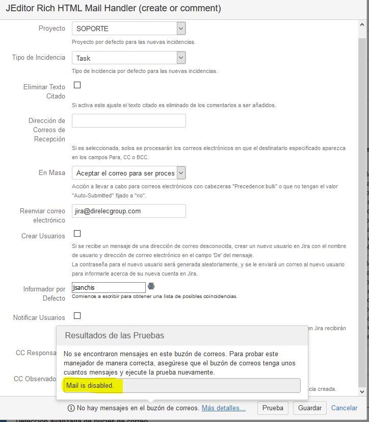

We have a problem for a few days. Jira doesn't import task emails from mail. When i try to test the connection to the gmail account, it's OK. When i try to force the import email, i see this error "Mail Disabled".
But the incoming and outgoing email are correct.
See the atachment.

Diego,
it looks like you might be using a 3rd-party add-on for your mail handler. Can you confirm if the built-in handler exhibits the same behavior?

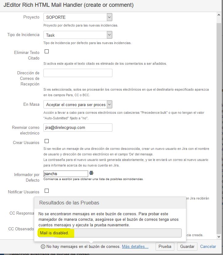

Hi Shannon, i have the same problem disabling the third-party addon JEditor.
The error is the same: "Mail is disabled"
