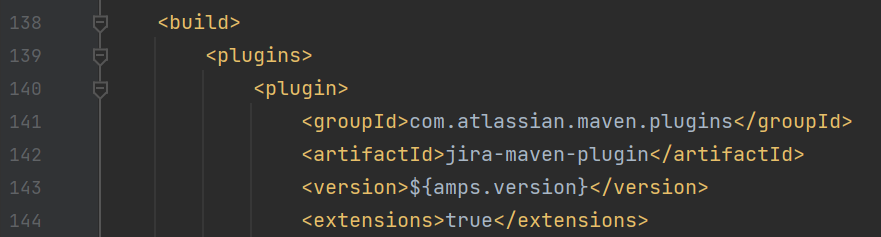

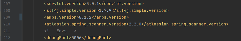

In my advanced-sla-pom.xml I define AMPS version 8.1.2:

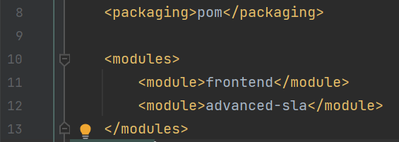

In main pom.xml I define 2 modules:

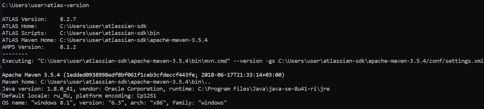

Below are my settings Atlassian SDK:

If you have a project with several modules. The command atlas-run must be run in the directory in which your Java project. In my case it is advanced-sla directory.
From this directory I could not run the plugin because I had installed the wrong version of Java 8. Installing JDK 8 from the Oracle website solved the problem.
