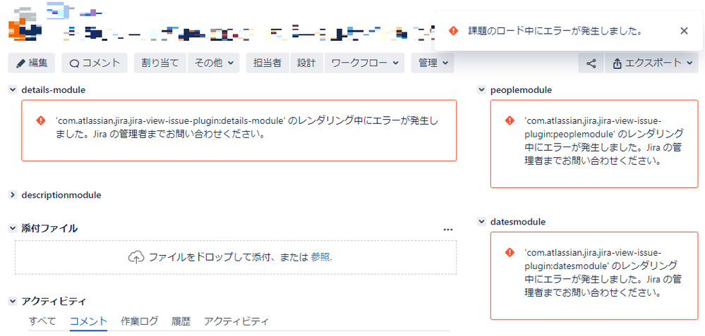

The following error will appear under the detail section of issue view page:
I did following page resolution (erase contents of <jirainstallholder>\work) but I still have same issue.

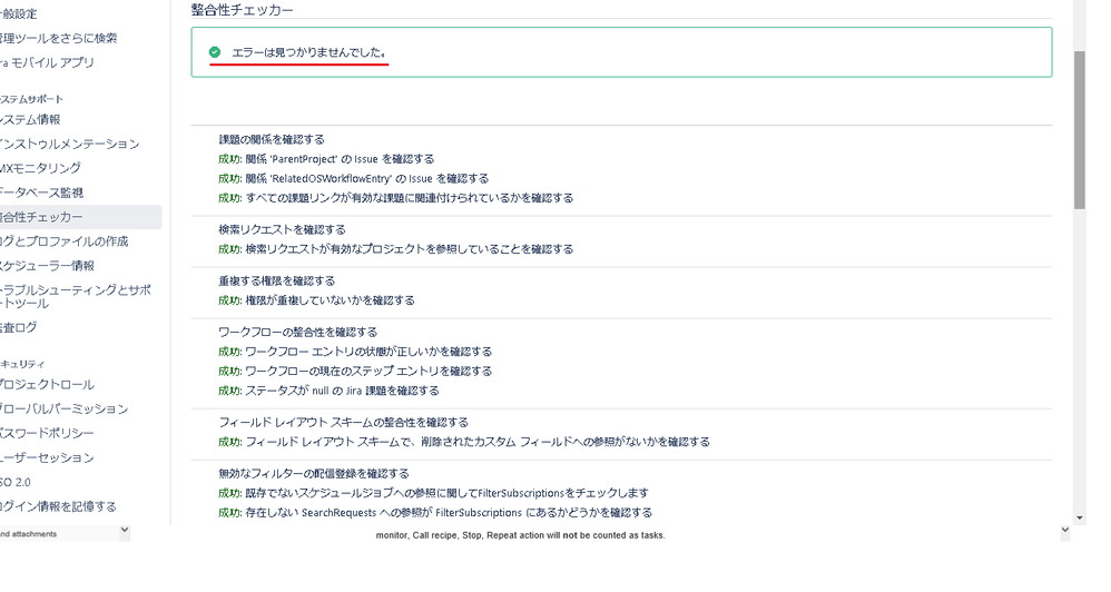

As you already followed the steps from the documentation, let's start with an integrity checker to try to fix the issue.
You can follow the steps from the documentation below:
- Using the database integrity checker

I did integrity check and everything looks fine but still remain the issue.

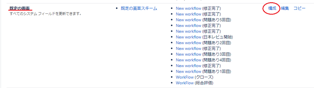

So, I go to Screens page.
JIRA Administration > Issues > Screens
Find "既定の画面" and Clicks 構成 link as following.

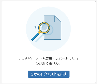

I've got the following error.
Please help how to deal with this.
