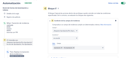

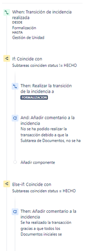

Hi! I need help, the following automation rule is failing and I don't know why.
I want to make the issue stays in the same status if subtask is not done yet, and instead if it is done, this can go to the next process.
It works well for me in general for both, the issue stays in the same status if the subtask is not complete yet, and it can go on to the next process, but it still gives me an error
As you can see in the following image, this is the automation
auto.PNGf

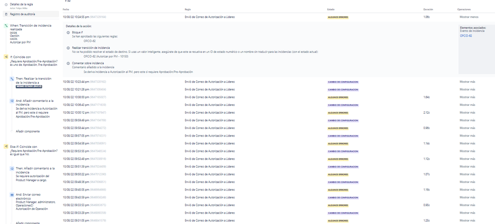

And the error shows up when i want to transfer the issue:
Detalles de la acción:
["10036"]
Bloque if
Se han aprobado las siguientes reglas:
OP-16
Realizar transición de incidencia
No se ha podido resolver el estado de destino. Si usas un valor inteligente, asegúrate de que este se resuelva en un ID de estado numérico o un nombre sin traducir para las incidencias (con el estado actual):
OP-16 (Gestión de Unidad - 10131)
Comentar sobre incidencia
Comentario añadido a la incidencia
Se ha realizado la transacción debido a que todos los Documentos iniciales se encuentran completos.
I need help, it works but i dont want the red mark in automation, and need to know if something is wrong

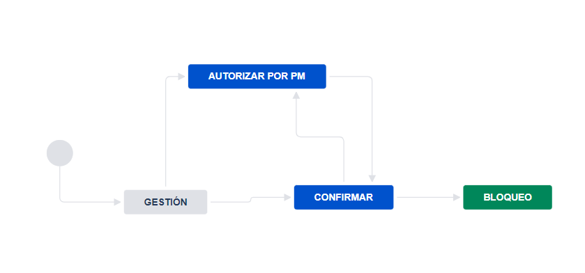

In addition to the two ideas I already mentioned, a third possible cause is that there is no transition in the workflow to the new Status from the Status currently assigned to the issue.
Can you show us the diagram for the workflow for the issue that triggered the rule?
What is the Status of the issue that triggered the rule at the time it triggered the rule?
Can you show us the Conditions tab for the transition that would occur given the current Status of the issue and the Status to which you are trying to change it?

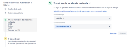

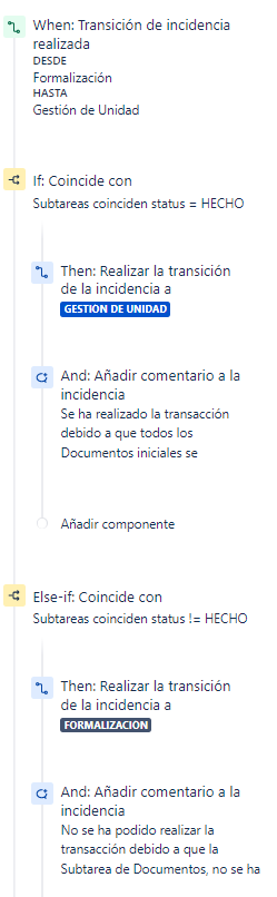

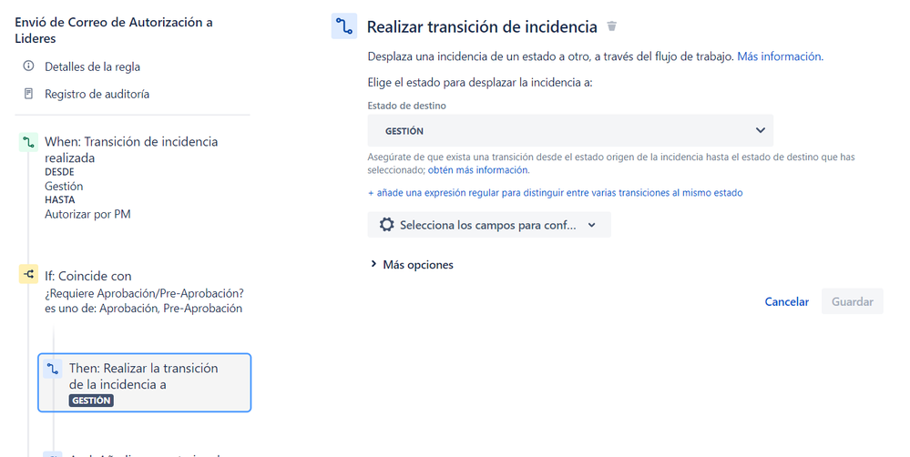

I'll show the elements
it start when i make a transition

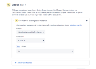

then the conditions, it is through a field with 3 options, I want that if there is any of two options, it returns to the initial state, and "else" if it's equal to a value (last option), the transition can be made
i've change status for a loop, and still doesn't work

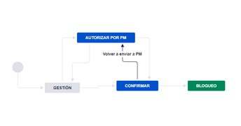

I attach the workflow that triggers the rule
And i have no condition in any transition
Felipe Wilke
August 10, 2022
Sorry! I realize that the workflow doesn't have a back transition to the first status, it works when i put a new transition, my bad!
