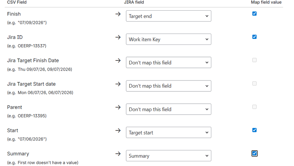

Screenshot 2026-07-07 174156.png                             I am mapping all required fields for me , and got around 100 warnings for 400 plus rows,
Gor Greyan
July 6, 2026
@keerthi_guntupalli
Thanks for sharing the screenshot.
The mapping looks correct to me, and since you can also update the Target start field manually using the same date format, it doesn't appear to be a date format or field configuration issue.
Could you share a sample row from your CSV (without any sensitive information removed)? I'd like to compare the values being imported with the field mapping to see if there's anything unusual.
And also, is the error occurring for every work item in the import, or only for specific ones? It may help determine whether the issue is related to the data itself or to a particular work item.
Jeroen Poismans
July 7, 2026
@keerthi_guntupalli , @Gor Greyan
I see something fishy in you import screenshot. You have ticked the "Map field value" column next to Finish, Jira ID and Start.
Have a look at the documentation of the importer:
https://support.atlassian.com/jira-cloud-administration/docs/import-data-from-a-csv-file/
There is a part in there that explains this toggle:
Set up field mappings
  1. ...
  2. ...
  3. To modify the values of any field in the CSV file before importing into Jira, select the Map field value checkboxes next to the appropriate fields.
So, what this means is that for every different value of the field you will have t do a manual mapping to another value. Typically used for fields like select fields, status ... etc ..
So for those fields I don't think this checkbox should be ticked.
You want the importer to take the values as is in the import file without manual mapping.
Try that.
