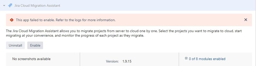

I'm running into issues trying to enable the JCMA.  It say's it can't enable.
I believe it's running into issues with the JAVA versions in installed.
I have 2 JIRA instances running JIRA 8.18.xx and 8.20.xx  Per Atlassian's documentation, running JAVA 8 and 11 should be fine.  However, I have a feeling JCMA needs something higher.
Thoughts?    Is there a JCMA I should try (un-install current and manually upload)

Hi @Tom Gross,
Do you use Jira Service Management? I've found this article that may be related to your issue: Unable to start the plugin container for Jira Cloud Migration Assistant plugin. Do you see any errors in the atlassian-jira.log while attempting to enable the plugin?
Reinstalling the plugin may help, please try to do it.

To get around the issue, I uninstalled JCMA 1.9.15 and manually installed JCMA1.8 from 3/2023.  Appears to have worked on both of my JIRA instances
  • v8.18.2 (2021-08-17)
  • v8.20.6 (2022-02-15)
I'm going to go with these for our migrations, since they work and are only 6 months old.
