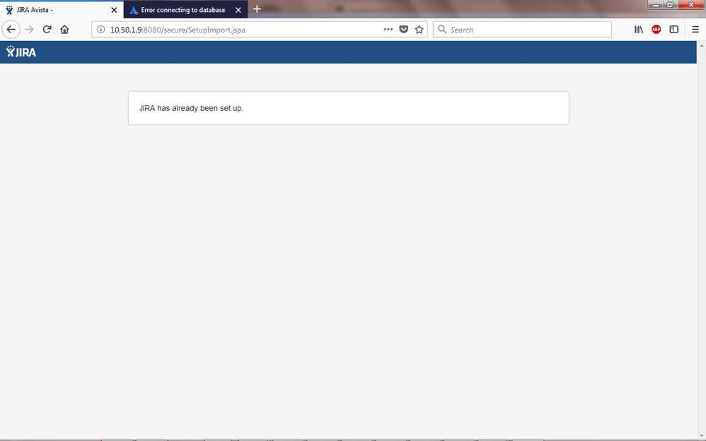

Thanks, I am now running into a different problem when trying to import the datas, I get the following report: "JIRA has already been set up. "
I have tried reinstalling v7.9 a couple of times but keep getting this message, do you know what might be causing it ?
Andy Heinzer
May 16, 2018
I'm not sure exactly where you are seeing that message.  However if you see that it tends to indicate that Jira is not using a truly empty database.  I would recommend that you
  1. stop Jira
  2. create a new database, with a different name, by following all the steps in Connecting JIRA applications to MySQL
  3. Be sure to update the dbconfig.xml to reflect that Jira is connected to this new database.  You can edit it manually, or use the Jira Config Tool.  Then save that file.
  4. Start Jira
By doing this, you can be sure that you are taken to the setup wizard of Jira.  For the sake of upgrading Jira, this is what you want.  You would need to use the link in the setup wizard called 'import existing data'.
This way makes sure that you are actually upgrading the Jira data when it is imported.
Otherwise, if you are actually already logged into Jira and trying to use the system administration menu's "Restore data", I do not have the same confidence that Jira will upgrade that data.  That restore data option in the system administration side of Jira is intended for restoring backups created on the same version of Jira.
Thomas D
May 16, 2018
Thanks for the suggestion,
I am unfortunately hitting that problem again.
I deleted JIRA by removing the /opt/atlassian /var/atlassian directories
Created a new database/user with never used before names.
Went through the JIRA install wizard, connection to the db was successful.
Started importing datas, browser switched briefly to the data import progress bar before reporting again "JIRA has already been set up", here's a screenshot.
Could you let me know what could be causing this ?
