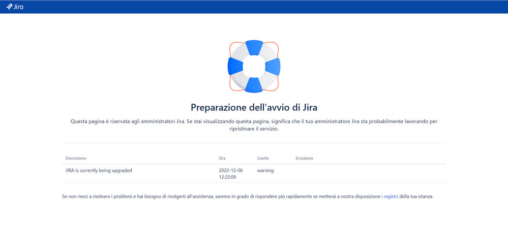

we try to upgrade from v7.1.0 to Jira 8.13.27 but nothing seems to work! In the log we find:
Jira 8.13.27 build: 813027 started. You can now access Jira through your web browser. Plugins and caches are being initialised.
but from the web broser we see the message "JIRA is currently being upgraded
2022-12-06 10:58:18 warning" and nothing is happening in the logs.
We also raise a support issue because we have to upgrade because of the OAuth 2.0 that is not support in our version.

Would you mind to post screenshot of access page of JIRA in web browser?

Chiara Squilloni
December 6, 2022
Nic Brough -Adaptavist-
December 6, 2022
That means what it says - your Jira is running ok, but it needs to upgrade the data to match the new version, so it's now ploughing through all the data changes.
You should be able to use Jira fine after it has finished.  You should be able to see progress in the application log file.

I'm unable to interpret language, can you please use English language and repost the screenshot?
