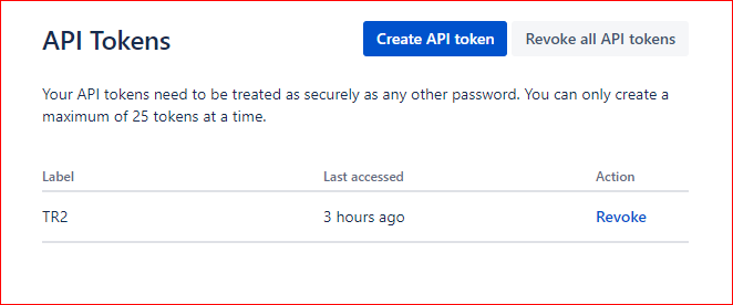

Katy Wynne
January 6, 2022
From JIRA > Account Settings > API Tokens:  Screenshot of it being accessed:

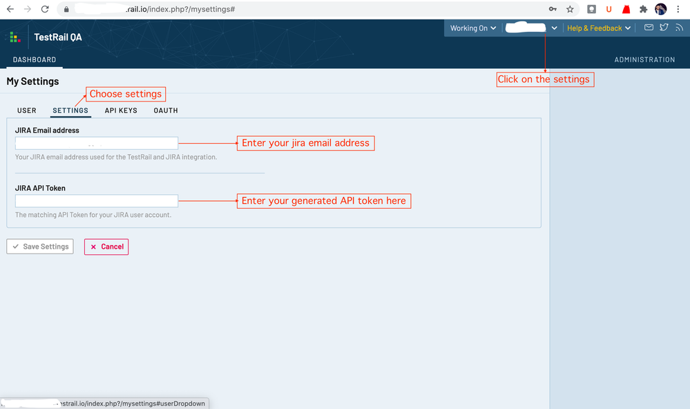

AK
June 21, 2021
you need to do one last thing to make it work. If you have multiple teammates working on Testrail, you should have each of them configure their own credentials by going to their user's settings under your name in the top right corner of my settings, in the settings tab. If you do not enter their own authentication credentials the integration will still work for them but the issue is if they push from Testaril to Jira this will be attributed to the user account associated with the fallback credentials. Once it's done the configuration is complete and you can start to use it without any issues.

Katy Wynne
January 6, 2022
I've attempted both of the steps above, the API is showing as being accessed within JIRA but I get either a 403 error or 404 from Test Rail depending on the project. I have full permissions on the projects, however I am using JIRA Service Management. I setup a trial version on JIRA and Testrail to follow from the beginning and having the same issue.
Is Test Rail integration not compatible with JIRA Service Management:
Testrail Version - 7.2.5.1000
Would appreciate some guidance into the above, it's frustrating to not be able to connect these two.
Like Pradeep Srinivasan likes this
AK
January 6, 2022
Hi Katy Wynne
How you create the token?
Like # people like this
Katy Wynne
January 6, 2022
