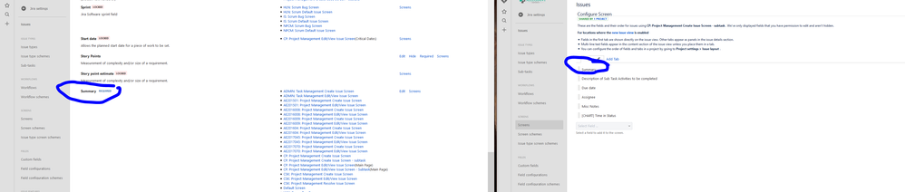

Okay - I am just adding more to this ticket as it took me a while to solve this very same issue so for all the non-techy users like me....These directions are not very savvy and likely not the easiest way to get to the screens - but it took me forever so I thought I would add some directions if nothing else to help myself next time to make the same error.
What I did to fix it:
Open up two tabs of JIRA
On one tab go to -
  • Jira Settings
  • Projects -->Projects
  • then pick your project
  • Project settings
  • fields
  • go to the gear in the top right "actions
  • Edit fields
On tab 2  -
  • Jira settings
  • Issues

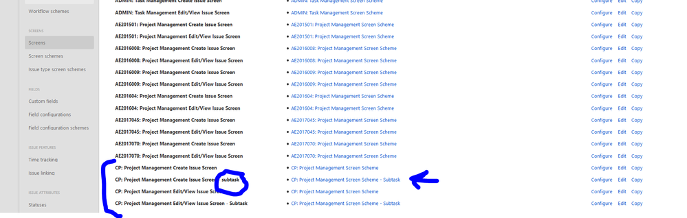

  • screens and look for the screens associated with your project that you set up for making subtaks different than tasks (you likely did like me and copied the task set which had required fields on it that you removed when you configured the layout of the sub tasks)
  • Click on the blue hyper link for the screen scheme (image below)
  • Then click on the blue linke for screen beside create issue
  • this takes you to the subtask configure screen where you selected fields
Do a side by side comparison of your required fields in "issues view field confguration" (tab one) and the fields in your "Configure Screen" (tab two)
Once you find a required field that is NOT in your list - either add it to your list or make it optional - refresh everything that that solved the issue for me. But I did have two required fields that I had to resolve.

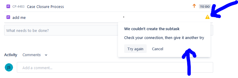

Here is a screenshot of the error Message:
Here is a screenshot of locating your screen scheme: probably clicking configure gets you there faster...
