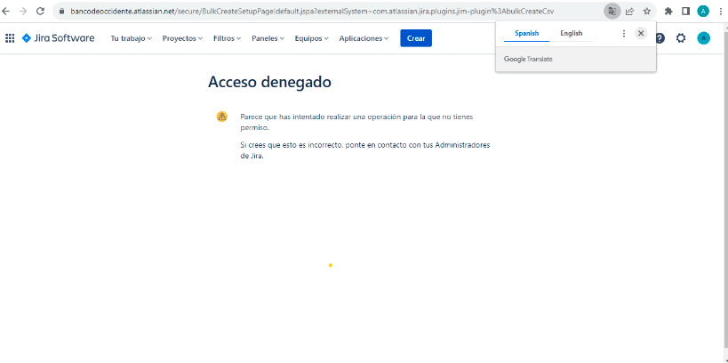

Buenos días;
Se esta presentando el siguiente error a un solo funcionario al momento de hacer el cargue, y no he encontrado a que se puede deber.Error Cargue Masivo Incidencias.png

Error Mass upload of Incidents
The following error is being presented to a single official at the time of uploading, and I have not found what it may be due to.
access denied
It seems that you have tried to perform an operation for which you do not have permission

Hola, muchas gracias por responder.
Si, efectivamente validamos que el usuario estuviera dentro del grupo "Hacer cambios Masivos" pero aun así le sigue generando ese error, lo raro es que de los 600 que tengo en este momento en la instancia solo a 1 le esta generando el error.

Hello, thank you very much for answering.
Yes, indeed we validated that the user was within the "Make Massive Changes" group but even so it continues to generate that error, the strange thing is that of the 600 that I currently have in the instance, only 1 is generating the error.
