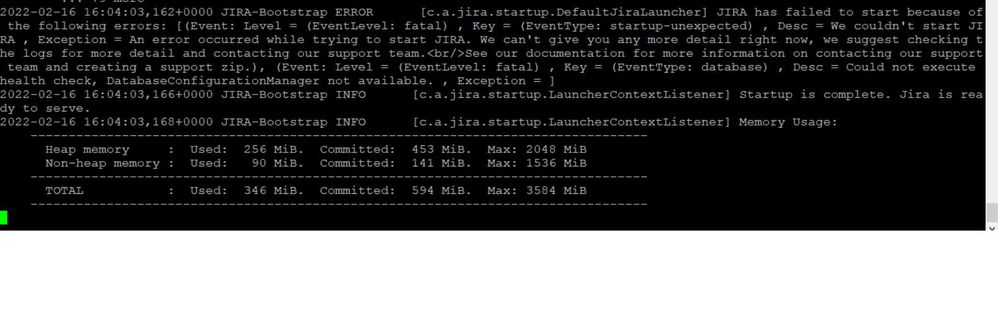

Matthew MacFadden
February 16, 2022
2022-02-16 15:59:04,734+0000 http-nio-8080-exec-1 ERROR anonymous 959x1x1 - 192.168.10.1,192.168.10.101 /rest/com-spartez-support-chat/1.0/chat/unread/ITSD [c.atlassian.instrumentation.Instrument] Unable to snapshot thread local operations (implementation of OpTimerFactory is not a ThreadLocalOpTimerFactory): null
2022-02-16 15:59:04,762+0000 JIRA-Bootstrap INFO [c.a.c.e.c.a.j.p.util.CachingProjectKeyStore.cache] Cache com.atlassian.jira.project.util.CachingProjectKeyStore.cache was flushed
2022-02-16 15:59:04,763+0000 JIRA-Bootstrap INFO [c.a.jira.propertyset.CachingOfBizPropertyEntryStore] ProjectPropertiesManager.Project.cache stats disabled: NoOpPropertyEntryStoreStats
2022-02-16 15:59:04,886+0000 http-nio-8080-exec-2 WARN anonymous 959x2x1 - 192.168.10.80,192.168.10.101 /secure/johnson/data [c.a.jira.security.JiraSecurityFilter] Rejecting security-sensitive request that bypassed Johnson filter: /secure/johnson/data
2022-02-16 15:59:04,900+0000 JIRA-Bootstrap ERROR [c.a.jira.startup.ComponentContainerLauncher] A fatal error occurred during initialisation. JIRA has been locked.
