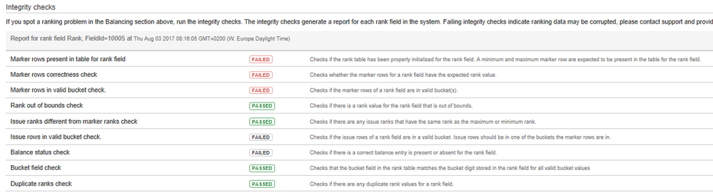

Alright, Branden McElveen's suggestion didn't provide a solution for me, but it led me on the right track... as it turns out it seems like the LeoxRank system has failed to properly initialize and thus pretty much all the initial markers were missing, the workaround suggested in the following bug report helped and now everything works just fine:
https://jira.atlassian.com/browse/JSWSERVER-10975

Nikolai Steffel
August 2, 2017
Sadly none of the adviced solutions worked, by the way running the integritiy check on the LexoRank management seems to return failures on all field ID's except 11300
