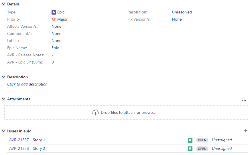

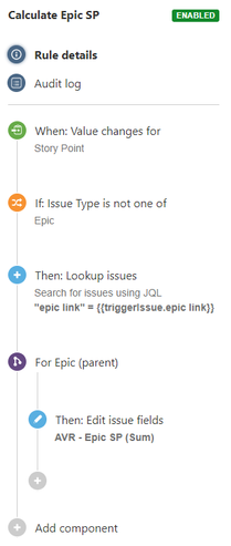

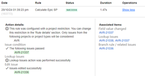

I've recently tried to set up a rule that sums all story points to the epics on a specific project (see screenshot for more details):

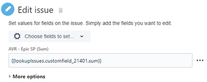

(*) Note: on the Edit Issue Fields action (last step), "AVR - Epic SP (Sum)" is the name of the custom field I've created to store the sum of story points. The smart value I'm using for this one is:

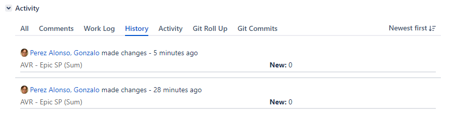

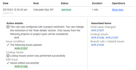

After testing and checking the audit log, looks like everything is working fine but the calculated custom field is not getting any update.
Any clue?
Thanks a lot in advance.

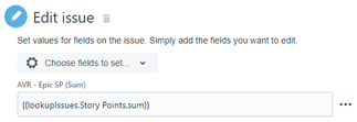

Can you give the details of your edit action in the branch?
I suspect it is something like: {{lookupIssues."AVR - Epic SP (sum)".sum}}, replace this with customfield_xxxxxx
Gonzalo Perez Alonso
October 29, 2024
Hi @Marc -Devoteam-
Thanks for replying! Here are the details:
Already tested and still no change on the custom field:

Are there issues related to the Epic that have not been estimated?
If so can you try the clause: {{lookupIssues.customfield_21401.sum|0}}
October 29, 2024
Yes,
Both US are linked to the epic:
After using the clause, nothing changed. Still value 0 for the custom field - the audit log keeps registering a success somehow.

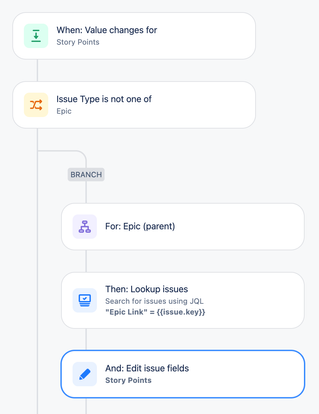

Marc -Devoteam-
October 29, 2024
Hi @Gonzalo Perez Alonso
I see the issue now, your lookup should be in the branch not before.
I tested this, see my example.
October 29, 2024
Hi @Marc -Devoteam-
That was my initial setup of the rule, but changed it after checking another thread where I saw this alternative. But none of these worked for me.
My sensation is that the smart value on the edit issue could be the key to solve this, as the audit log is showing that the rest of the rule is properly designed (issues passing and actions performed)
Marc -Devoteam-
October 29, 2024
Are you using the correct Story Point field, do you have multiple?
This rules works on my side.

Bill Sheboy
October 29, 2024
To isolate the problem, I recommend writing this to the audit log after the Lookup Issues action, then re-test your rule:
Story point values: {{#lookupIssues}}{{key}}:{{Story Points}}; {{/}}
Story points sum: {{lookupIssues.Story Points.sum}}
That will confirm the values are set for the issues in the lookup result.
And what is the type of the custom field where you are trying to store the result?
