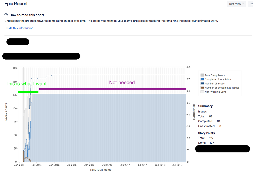

I have an Epic that I marked "Done" from the Backlog so it no longer appears on the Epic list in the Backlog view.  But when I look at the Epic Report the graph shows data up to the current date. Since this Epic was finished several years ago the Graph compresses that actual time we worked on it and shows a lot of useless data.
How do I get the graph to only show up to the time I marked the Epic "Done" in the Backlog?

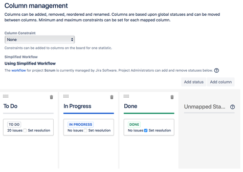

Since you mentioned that the Epic was marked as Done already, can you please provide me with the screen shot of the Column Management section of this board? For example:
This will confirm if the Done was set to right most column or otherwise. Thank you.

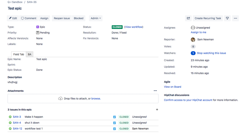

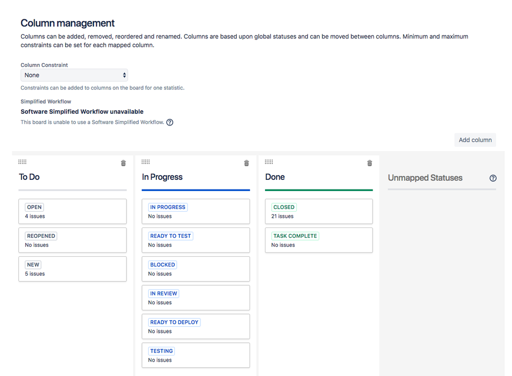

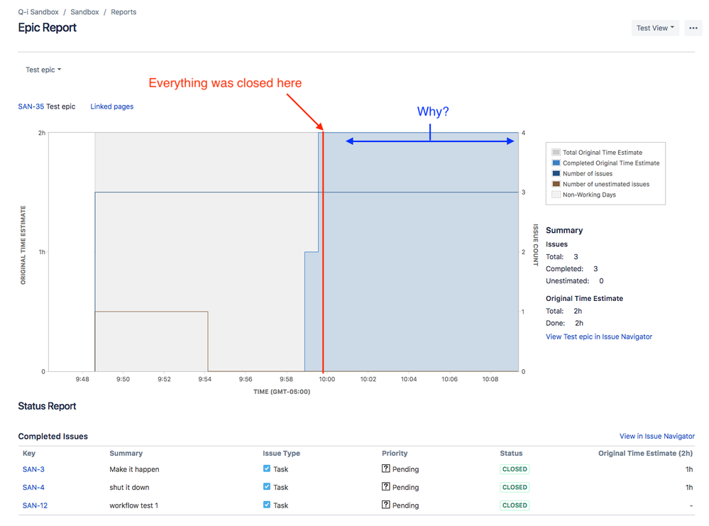

I created a test Epic, put some issues into it, and closed them.  Then I set the Status of the epic to Closed, then I set the "Epic Status" (different field) to Done as well.
The Epic Report graph continues to grow.  Any ideas? Epic Report.pngEpic Status screen.pngColumn Management.png

Thank you for the detailed clarification. I had a discussion with the team on this and based on the examples provided, we cannot stop the timeline as it is a report based on "today" and is mainly for tracking any un-estimated or incomplete stories. Once it's done, there shouldn't be a need to track remaining incomplete / un-estimated work by default.
Nevertheless, I see your point of having the ability to restrict the timeframe in the graph in case there is a need to revisit closed Epic graphs in the future. Ideally, you would like to have the ability to adjust the timeframe of the graph to make it look cleaner and not include unnecessary dates.

The use case for me is that I want to be able to see the completion time for a project (Epic) so I can use it for estimating other similar projects before going deep into the story writing/poker process. I was expecitng the Epic Report graph to behave similarly to the Version Report graph in that it stops on the Completed date set for the Fix Version.
It would be usefull to have the Epic Report behave in a similar way or have some other way to get the information I am looking for (time to complete an Epic.)
