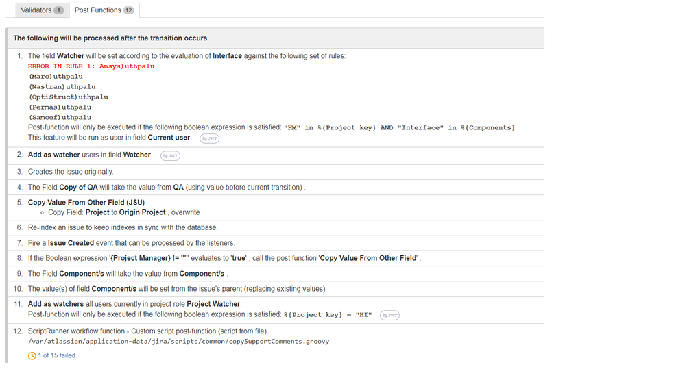

We are using Jira Suite utilities plugin, Below is the screenshot of postfunctions on Create issue. But this was not changed since last two months and we started seeing the epic issue last week
postfunctions.pngPlease help!

Well, those appear to be a lot of post functions for the create transition.   However it might also help to examine all the other transitions that can exist here for both the epic issues and the issues in those epics.
Something appears to be creating invalid epic links.  But figuring out exactly which process is doing this could be very difficult to identify.
