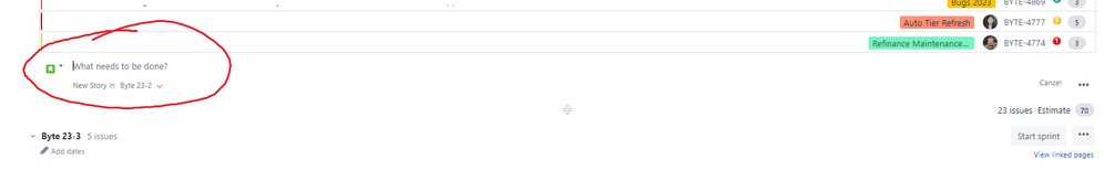

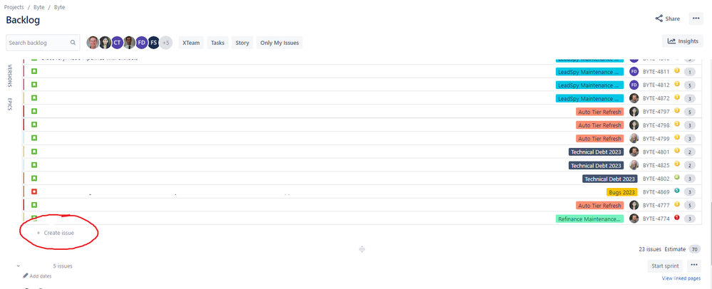

When I am in the backlog and click 'Create Issue' in a particular sprint, I do not get the Create Issue pop-up modal for me to fill out the details of the issue. It only gives me the option to type text and submit which immediately creates the issue in the backog.
I am looking for the system to pop up the Create Issue modal where I can add all the applicable details before actually creating the issue. How can I enable this setting?

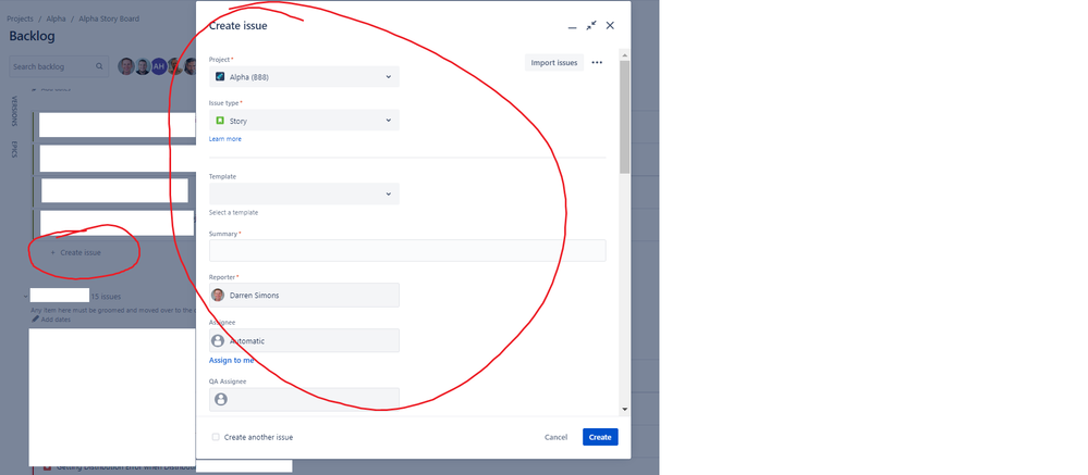

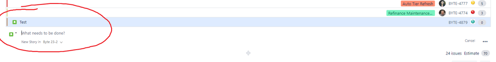

The functionality I am referring to is in the attached screenshots. From one of our projects, once you click create issue it just forces you to type in the issue details and creates it inline. For the other, when you click create issue it pops up the modal and lets you edit all the details before actually creatingCreate Issue 1.pngCreate Issue 2.pngCreate Issue 3.pngCreate Issue 4.png

For the projects where the Create Issue dialog is displayed, are there additional fields that are Required besides Project, Issue Type, Summary, and Reporter?
When there are more Required fields, per the Field Configuration for the project/issue type, then the Create Issue dialog will display.

I was able to find a work around from your response above where I did make more fields required in my project and the modal pops up after you type your summary and click create now (so not on clicking create the first time, but rather after you type your "What needs to be done?" and then hit enter it pops up.)
