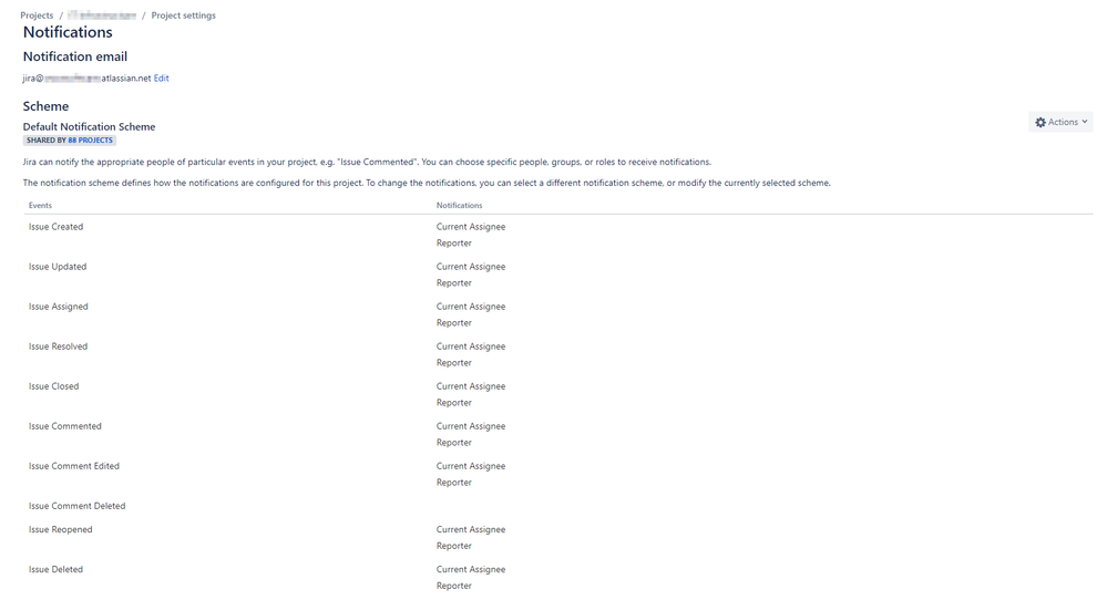

You would configure the notification scheme in the project, either create a new one or reuse one with the settings according to your preferences.
It all depends on what settings you've set, do you want others than the reporter and assignee to receive notifications, by default only the reporter and the current assignee will receive notifications?

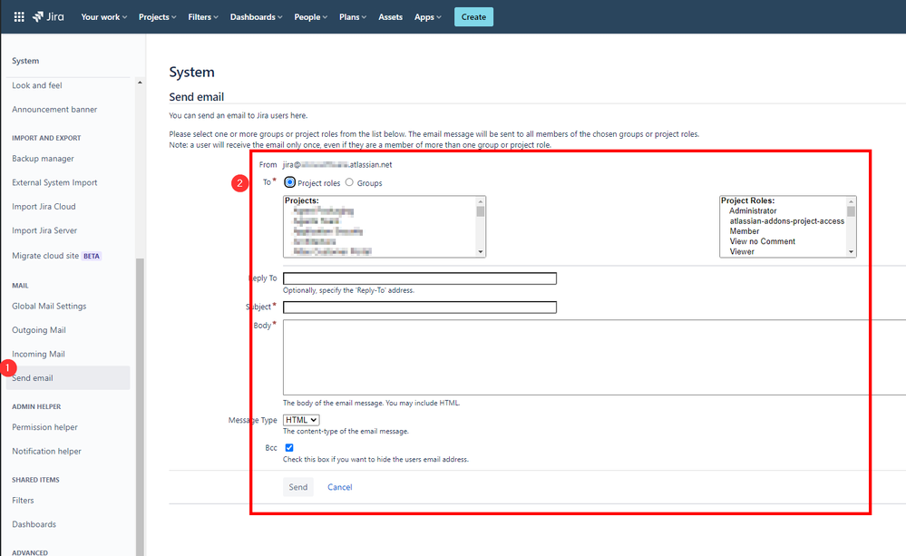

You could also try the mail settings from the Jira Settings page
