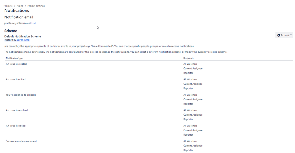

Hi @Michael Schmitz ,
The first thing that comes to mind is, is that somebody changed the notification scheme. So I would suggest to look there first. Project settings > Notifications
If the recipients column is empty or missing relevant recipients, then you know that this is the issue.
Good luck

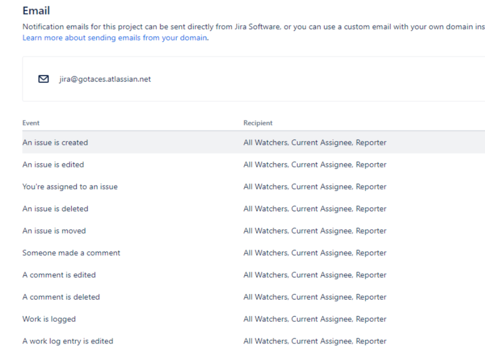

Michael Schmitz
February 2, 2024
Thanks Jira Email.png@Rudy Holtkamp, but I have checked, and they look fine to me

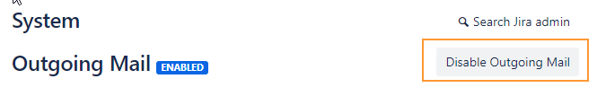

Maybe someone disabled all email?
Michael Schmitz
February 2, 2024
Our Outgoing Mail is set to Enabled, so this isn't it.
