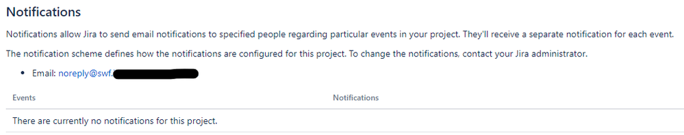

when changing to the smart value there is no change (no email, audit log status still success). I have now tried to get an email from another automation which also did not work. Apparently there are no other notifications which I can see according to the notifications tab within the project settings:
However I know that some colleagues have complained about the abundance of automated mails within Jira, therefore I think I am messing up something right now. I am fairly new to Jira, could you elaborate further on this topic?

could you confirm with your Jira administrator that the Outgoing Mail in System settings is enabled?
I would also recommend contacting your Jira administrator as there is no notification scheme set up on this project you are using.

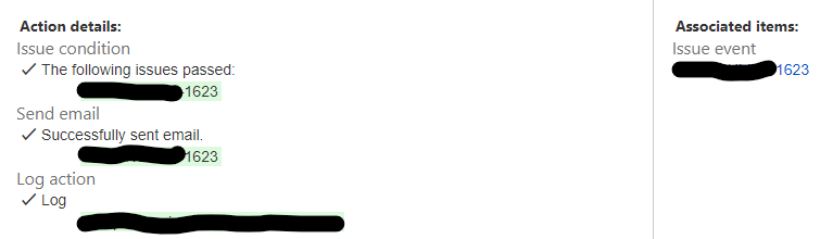

Yes the issue condition has passed, I will inlcude a screenshot of the audit log:Screenshot 2023-07-28 094236.png
The email adress is correct in the log. And like I said, I replaced the email with my private one and there were no changes unfortunately (spam folder is also empty for both cases). I do not get any other email from jira, but I am also not assigned to any active issues. I am solely responsible for some administrative tasks, so I thought this would not be an indicator for issues.
