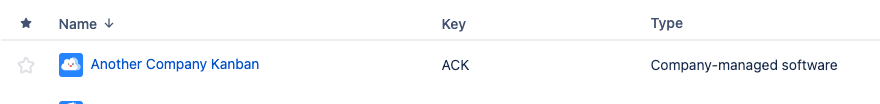

Alternately if you go to Projects > View All Projects, and find your project, its type should be displayed in the Type column.
