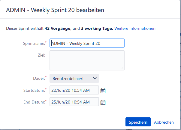

Can you confirm if you have the option "Sprint Beenden" under the three dots menu and check if it provides you with the display to edit the start and end dates?

thank you very much! I can confirm, that's the wrong translation. "Sprint beenden (End Sprint)" opens the "Edit Sprint" menu.
I will vote for the bug - but your comment solved my problem as a workaround.

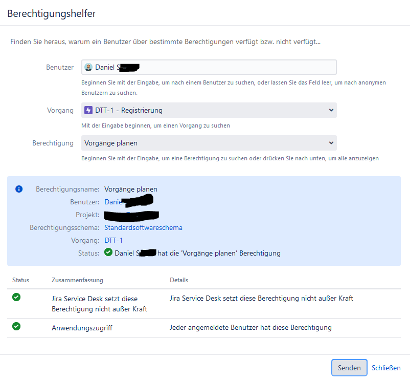

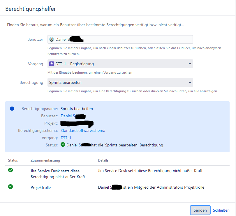

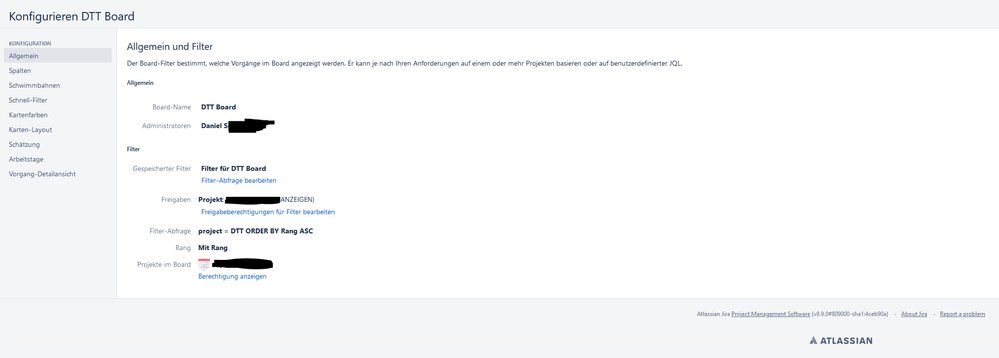

1. The problem we're facing is that I'm neither able to rename sprints nor can I change start and end dates. If I hover over name or dates nothing happens and the three dot menu on the top right of the sprint just allows me to end the sprint or delete it if it's a future sprint. The interface looks exactly like on the screenshot that @Marcel E_ posted.
2. The general settings look like that:
3. The permission helper shows this:
Additionally I ran the integrity checker and it even found a permission problem, though fixing it didn't help in any way and the problem still persists.
