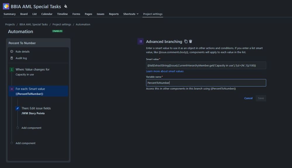

Mona Aghamirsalim
June 1, 2023
Diana,
I am trying to do the same thing. JWM Story Points is a numeric field. Capacity in use is text. I am not able to get this work. even without the /100 the formula didn't work for me.
1. what does the 1 in the formula mean?
2. what am I doing wrong :( ?
