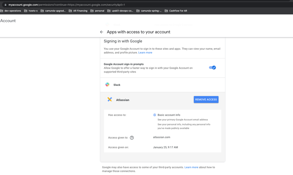

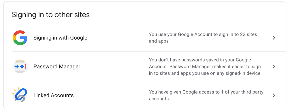

duke.le
March 13, 2022
We resolved this issue by removing the Atlassian from our Google profiles
