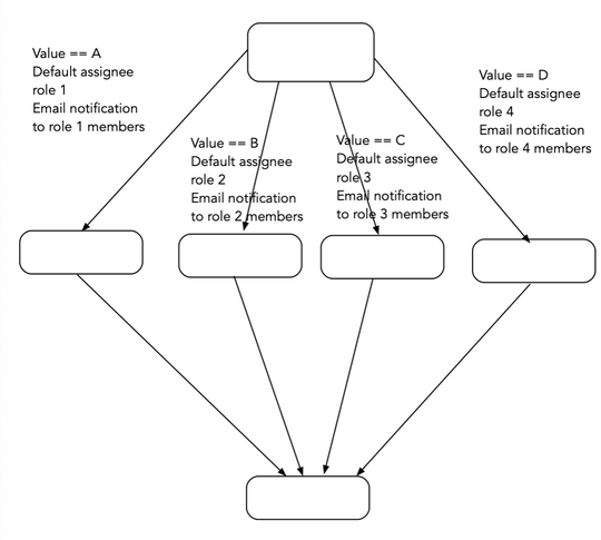

Maybe a drawing makes things clearer.

Did you read my previous post?
As for your schema, the problem is that there is no notion of "role assignee" in Jira. You can only assign an issue to a single user. So I'm still confused with Wyatt you're trying to achieve.

Maybe initially I was not very clear in my writing. Let me rephrase. The process I need to implement is an approval process which needs to be approved by different people depending on the value of the select box. So I imagine this requires 4 different transitions, here in the middle of the diagram, that after 'approval' go to the bottom status.
Without the select box , In JIRA core, users would have to choose one out of 4 transitions to trigger the correct approval process. I'd like to avoid having the user to choose which transition to trigger from the 4 but rather have that dealt with transparently.
Your suggestion with the scripted groovy Condition could be a way to go.
