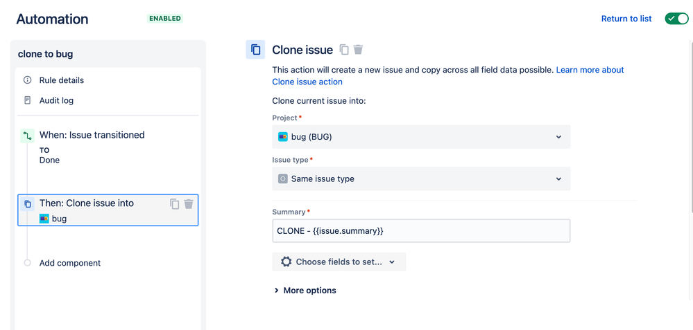

Hi @Nonla KONE
You could use an automation rule to achieve this.  The trigger could be when the issue is transitioned to a specific status, such as Done.  You could then create an automation rule to clone the issue into a different project.  More details on that action in https://support.atlassian.com/cloud-automation/docs/jira-automation-actions/#Clone-issue
Your automation rule might look like this.  I hope this helps.
Andy
