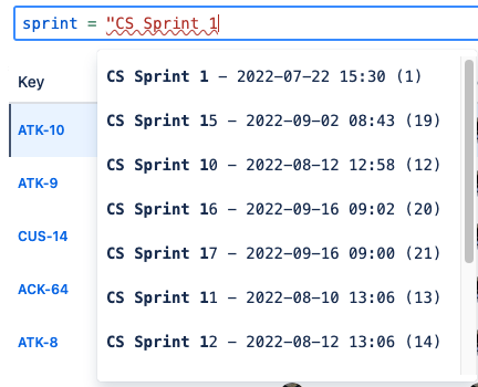

Go to the View all issues page under the Filters menu. Start a filter using sprint = and then start typing in the name of the sprint. Potential matches will display. Example:
Type in as much as needed to zero in on the specific sprint name. Share the results with us. Do you see two identically named sprints with different ID numbers (the number in parentheses on the right)? If you see only one matching sprint then you definitely have only one sprint shared between the two boards.
It is possible that two identically named sprints were created, but the boards are still sharing just one.
Complete the above JQL by selecting the sprint, and review the results. Do you see issues in that sprint such that there are some that belong to the Team A board and others that belong to the Team B board?
