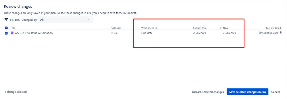

Hi @Daniel Lopez
You need to Review the changes in Advanced Roadmaps in order to sync the changes in the Jira issue
https://support.atlassian.com/jira-software-cloud/docs/save-changes-made-in-advanced-roadmaps/
Below is the reference

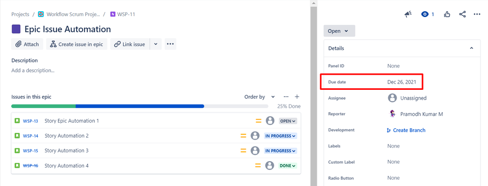

You can see here, we have a Jira Issue Due date changes being confirmed
And this is the Issue in Jira
