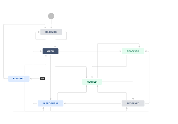

The workflow defined is

Looking at the above diagram we need to first ascertain if a transition exists at all. You said the issue is in the To Do column, but there is no To Do status in the diagram. What is the actual current status of the issue you are trying to move?
I can see that there is a transition from Open to In Progress, and from Reopened to In Progress. I see a transition coming into the bottom of the In Progress status, but I can tell where that comes from.
To see the details of the transitions to see if there is a Condition in them will require Jira Application Admin or Jira System Admin access.

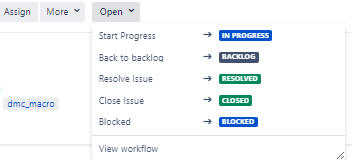

My bad. It is not Jira Cloud but Jira server set up although company managed server is in the cloud. Also, I may have caused the confusion by giving the workflow. Attached is the drop down to change status of an Open item where Open is one of the status in the 'To Do' column. Also, attached is the project details snap shot.image.pngimage.png

Is the list of the available transition shown in you last response taken from the same issue you are trying to move on the board?

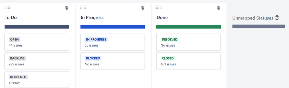

Can you provide a screen image of the Columns page from the board configuration showing the mapping of the In Progress status to a column?

yes, the available transitions apply to the issue I was trying to move.
Attached is the snapshot of Columns page

Sorry Trudy, it seems that the attachment did not go through. Here it is

Thank you for providing that screen image.
So far I can't see a reason for you to not be able to drag the card to the In Progress status in the In Progress column.

@kamal.a.nayan the possible statuses that you can transition TO depend on the workflow rather than which statuses are assigned to each column.
In general you can only transition to a new status if the workflow has a connector (arrow) from the existing status to the new one OR when the destination status has a connector that says ALL next to it.
In your workflow there is no connector from 'Backlog' to 'In Progress' so if your issue status is 'Backlog' you won't be able to drag and drop it to 'In Progress' even though 'In Progress' is mapped to the In Progress column.
However since 'Blocked' has the ALL entry next to it, you will be able to drag and drop a 'backlog' status issue from the To Do column to the In Progress column (which has 'blocked' mapped to it) but it will only be able to transition to the 'blocked' status.

Once the status is changed from Backlog to Open, I get 2 boxes where I can drag into - Blocked and 'In Progress'.

For clarity, I had asked if this image you provided
...was for the same issue that you were unable to drag from the To Do column to the In Progress column, and you said it was. Based on those statements I believed that the issue you were trying to drag between columns was in the Open status when you tried to drag it, and in that case it should've been able to be moved.
As we have learned from your dialog with Stephen, you were actually trying to move an issue that was in the Backlog status, and so the above image could not have been from the same issue you were trying to move.

To clarify, it was for the same Jira however it seems that when dragging did not work, I changed the status to Open and then to In Progress using drop down but never attempted to drag after changing the status to Open.
When Stephen responded, I attempted dragging the other items, some of which were sitting in Backlog status while some were Open. It is then when I realized that I was able to drag the ones in Open status and not the ones in Backlog status.
