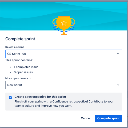

When you Complete a sprint you should be getting a pop-up that tells you how many issues are Complete and how many are Incomplete.
Did you get an pop-up like that indicating you had a number of open issues?
When you Complete a sprint, only the issues in the column farthest to the right will be considered "complete". Issues in any other column, regardless of the Status value, will be considered "open" and will be moved to the next sprint or backlog as per your direction.

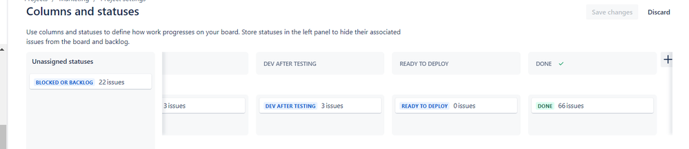

maja_vuchkova
July 26, 2024
It's a Team Managed project. I saw the pop-up, but I had already updated the status to the latest one yesterday. As a result, all the "done" tasks moved to the next sprint. Is there a way to reopen that sprint, or do I need to close this one and change things in the next one before moving forward?Screenshot 2024-07-26 135652.png
Trudy P Claspill
July 28, 2024
If your system is configured to allow Parallel Sprints then you could reopen the previous sprint. To do that you would need to go to the Sprint Report to find that sprint and reopen it. But that alone will likely not solve your problem.
An issue can't be in more than one active sprint at a time, and I'm not sure what Jira would do if you tried to reopen that sprint when it's issues are already in an active sprint.
At this point it may be better to continue with the current sprint and see what happens when you start the Completion process. If you have the flexibility to pause the completion of the current sprint, then I recommend you do so, so that the state of the system at that moment can be reviewed.
I would suggest that you look at the sprint report for the previous sprint and see in which group your previously done issues are listed. They should've been listed in the Issues Completed in Sprint section. If they were not, that problem needs to be investigated, but you may have to wait until you are ready to end your current sprint to see if the problem occurs again. If it does, then before starting another sprint the problem should be investigated more.
It would also be a good idea to let your Jira Admins know about this issue. If it becomes necessary they can open a support case directly with Atlassian. Then, with you admins' permission, Atlassian engineers could connect directly to you system to look at the data.
Here we are a community of users. We can offer you debugging tips, but we can't access your system directly. So there is a delay while we ask you questions, wait for your response, then offer new suggestions.
