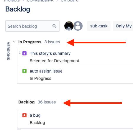

As to why the Done issue is showing up in your Kanban backlog, I need more information.
The Backlog screen lists the issues in two groups with one group displayed above the other. The lower list always has the heading "Backlog". The heading for the upper list can vary. Example:
Is the "Done" issue appearing in the lower list or the upper list?
Is this board for issues in a Company Managed project or a Team Managed project?
