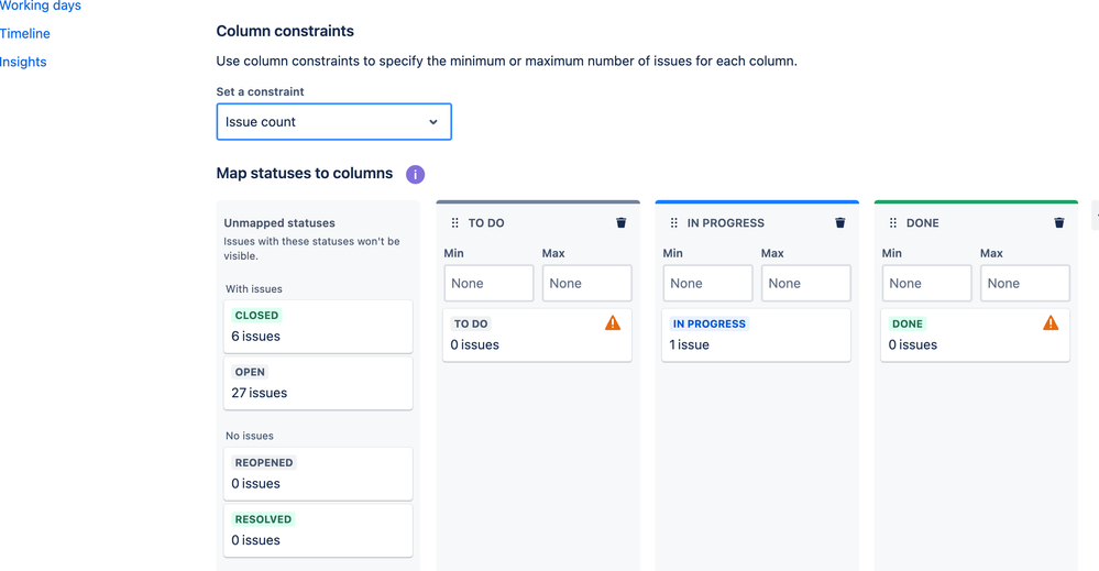

3. Jira doesn't have issue numbers, however you can set the limitation of issues on a board:
  • Three dots on your board in Jira
  • Configure board -> Columns
  • Set a constraint -> Issue count - here you can define both minimum and maximum of issues that you want to have within certain columns
