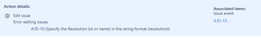

I've configured what @Dana Weinbaum has configured above (both automations for adding and removing Resolution) but it seems like the automation to remove the Resolution only works half the time. Are you also having this experience? When it does error I get the following:

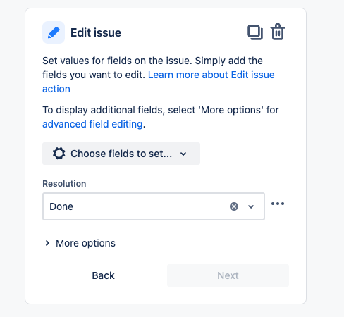

The workaround I found is to create an automation that when an issue is transitioned to a Done status -> update the resolution to Done as well.

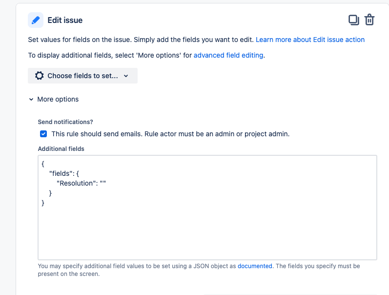

mmmmm that's strange, it works for me. And I just created the opposite automation, to unresolve an issue if it was reopened, In which case I added an advanced operation to leave the resolution field empty. check the 2nd screenshot.
