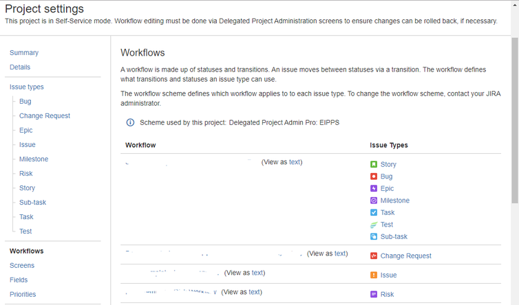

I've tried to clone a project template in our project using Self-Service Mode. I've used an issue type of Story which already exists in our previous project template. I've seen a same thread saying that "Please note that if you select an Issue Type that is already being used by any Process Template associated with the project, the selected Issue Type will be removed from that other Process Template so it can be added to your new copy. "
link: https://wittified.atlassian.net/wiki/spaces/DADMIN/pages/247267329/Using+Self-Service+Mode+-+2.1
I want to confirm if this would affect the other existing workflow in our project settings. With the said issue type as "Story" created from the process template.
Would like to know how the process template relates on the project settings of Delegated Project Administration screen.
Note: I only have access as Project Administrator.

A Process Template is a set of configuration options that control the workflows, fields, issue types, and groups that can be applied to issue types of Project. Whenever you map issue type with new process template the configuration with issue type will changed according to the new process template.
With respect to your query, other workflow will not get affected by copying new template for Story issue type.
Please find below scenario based example for better understanding on this.
  1. Let’s assume Story , Epic and Task are tagged to Process Template A and Bug is tagged to Process Template B
  2. Copy the Template A to new template called Template C and Map Story issue type to copied Template C and this action reflects all configurations associated with Story Issue type to be copied to Template C. Now if you go and check your project settings--> workflows page you will see same workflow for Story , Epic and Task issue types.
  3. Once if you make a change to the workflow in Template C which is created for Story Issue type you will see that workflow is copied and new workflow gets created for Story Issue type.
  4. Also configurations associated with Epic and Task remains same with Template A and their workflow is different from the Template C.
  5. Please let us know if you have any question(s) and happy to help you.
