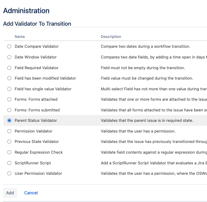

The subtasks display on the board because they are getting set to a status that is mapped to a board column rather than a status mapped to the Backlog. If you don't want the tasks on the board, then don't change their status to one that is mapped to a board column.
You could create a workflow specifically for Subtask type issues. In that workflow you could add Validators to the transitions to later statuses so that a check of the Parent issue status will be executed. The users could attempt to transition the Subtask, but if the Parent issue wasn't in an acceptable status then they would get an error message and the transition would not be completed.
