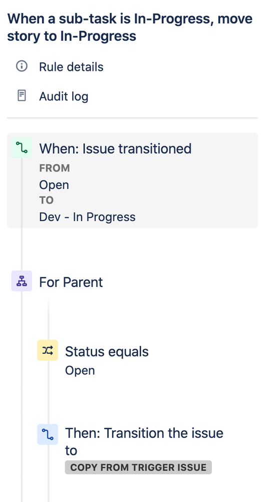

I have an automation for placing the story In-progress when a subtasks is moved to in-progress. This has been extremely useful but has then broken when we tried to move it to a global setting for the entire organization.
It's since been disabled but continues to no longer work in my project. It seems to have an override somewhere as my logic seems good.
What can I do?

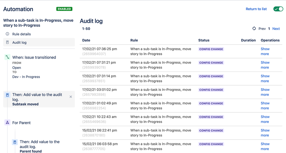

Hello Jack! Thank you for your tip of the log action. I've added the logs now and tried to move my subtask but there are no logs or action which leads me to believe the trigger isn't firing as expected.
From my reading, "Parent" would be limited to make the main story and not the epic but that could be an improvement in my logic
The action is limited to a single project.

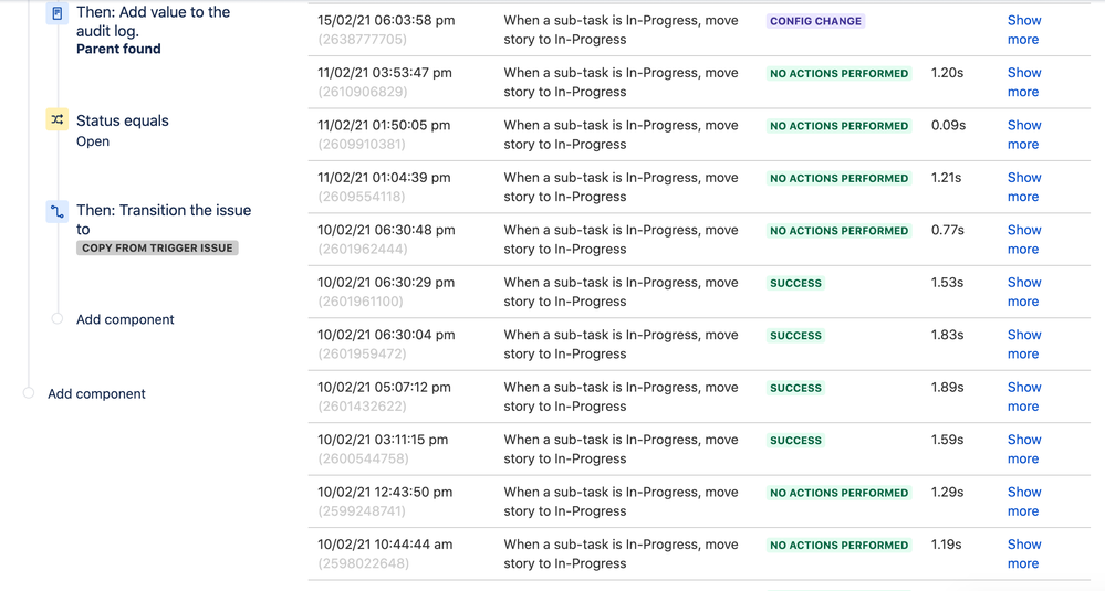

Screen Shot 2021-02-17 at 7.41.55 PM.pngScreen Shot 2021-02-17 at 7.42.00 PM.png
Jack Brickey
February 17, 2021
So I see a lot of config change entries but nothing after. I need to see a trigger and then expand the log.the last trigger at 3:53:47 shows no actions performed. Can you cause the rule to trigger and expand the log?
mmcneil
February 17, 2021

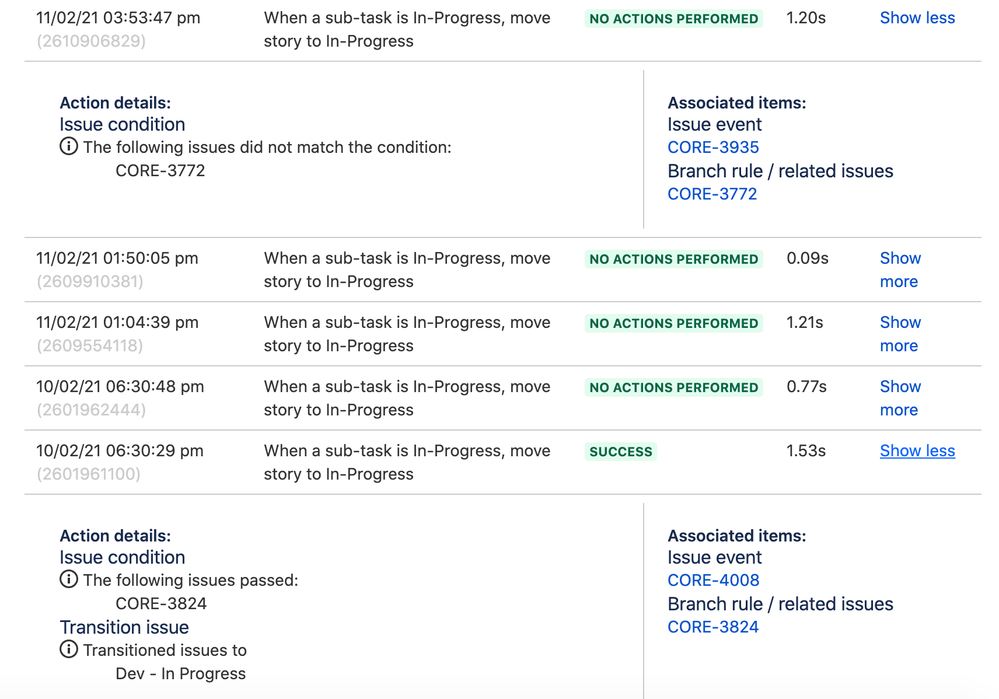

That's the issue, the rule no longer triggers. Here's a view of the last time it's triggered succesfully.
I've created a new story, add a subtask, and then moved the subtask in-progress but nothing in the audit log.
Jack Brickey
February 18, 2021
If you are sure that the event is actually occurring such that the rule should trigger then it might be easier just to replicate the rule. Try copying the rule and applying to the one project in question and see if that gets you working again.
