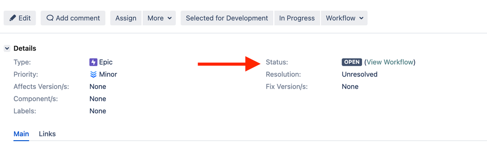

When you are viewing the issue details for an Epic you should see at least the Status field. Here's an example:
As I said the "Epic Status" field is not, by default, included on the screens for displaying Epic issue details.

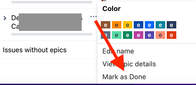

The Epic Status field is set by using the Mark As Done option for an Epic from the Epics panel.

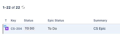

If you use the Issue Search screen and change it from Detail View to List View you can add the fields Status and Epic Status field to see the values of each field. This is an example (from Jira Cloud)
