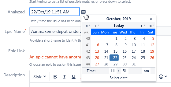

The problem only occurs in the 'Release date' and 'Analyzed' fields. A calendar is linked to these fields. Then AM / PM is used. See screenshot.
2019_10_22_11_52_08_Edit_Issue_TB_221_ACCEPTATIE_Nationaal_Archief_Jira_Internet_Explorer.png
For the other fields there is automatically time stamp used and you see 24 hours. See screenshot.

Thanks you for the clarification and the screenshots, and that makes a lot more sense now.
It is not what I initially thought, where the time and date were different in the same location in the respective projects, but rather the dates in the date and time picker field are displaying the unwanted formatting apposed to the alternate date picker fields.  And this is a setting for the date and time picker fields directly.
That setting is configured  and adjustable under Admin >> System >> General configuration, then switch from General setting to the Advanced Settings menu.
for the configuration to be 24h time in both locations you want both jira.date.time.picker.java.format (for the server side time settings)  AND jira.date.time.picker.javascript.format (For the client side settings) to line up and set them to:
  • jira.date.time.picker.java.format = dd/MMM/yy H:mm
  • jira.date.time.picker.javascript.format = %e/%b/%y %H:%M
And you should be all set.  And some additional examples on the formatting can be seen in this KB article

Yashvant Gadjradj
October 24, 2019
Thank you, the problem has been solved
